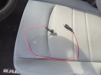

Disconnecting the negative terminal alone will not reset the computer. You need to drain the capacitors also. See pic attached, connect one end of the wire to the + positive and the other end to the Unconnected - Negative battery CABLE, NOT the negative battery terminal. Let that drain the power for about 30 min.
Important: Restart must be on a dead cold motor.
Important: After starting, let the truck run in park until it reaches normal operating temperature. The computer is relearning fuel tables.
Not sure this will help with your problem but this will reset the computer. And hopefully fix your bogging.

Be SURE the negative battery cable does not touch the negative battery terminal during this process.

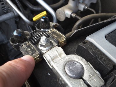

Could just pull both cables and put them together, should get the same result? Didn't think about the cold start, maybe I'll pull both cables and put them together overnight and see how that does? How many miles does it take driving for it to relearn?
The only reason I didn't want to touch the cables together is because the Positive battery cable has two small fuses and I didn't want to blow one or both. See pic. For the relearn mileage I'm not sure. Guys at the track will do this and then run hard to get a good aggressive base line and wipes out all the daily driver data.
Just checked both fuses and they're good. Landed the Pos cable back on Pos terminal and left a jumper wire between the Pos cable/terminal and the disconnected negative terminal. Going to let it sit overnight and start it up first thing in the morning.
Just out of curiosity, where can you find either of those fuses, dealership? Never seen that type before.
The jumper wire needs to go from positive battery cable/terminal to the disconnected negative battery cable not the terminal. As for the fuses I have no idea, I was scared to blow one because I have no idea what they do LOL.
Hope this woks for you.
My bad, it is going to the disconnected negative cable to the connected positive.
