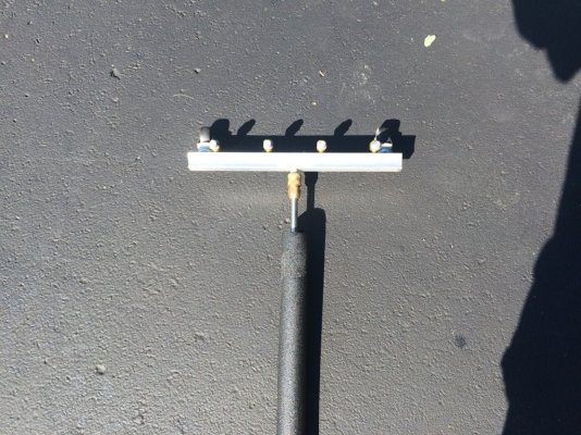

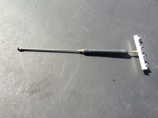

Undercarriage washer I made for the spring once the salt is washed off of the roads. You can now buy it off of Amazon. We also get our vehicles Krown'd periodically with touch up in between with Fluid Film & CRC Marine Corrosion sprays. As others have said, make sure you pull the tail lights out and coat between the inner & outer panels generously.
