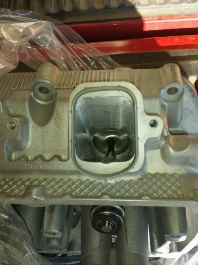

My ported heads and cam ran me $2500 in parts and I did the install myself. The ported big valve heads were $2k and the cam was $460 but that was about 5 years ago. I did do the Eagle head swap for the higher compression but the oem heads were the same price for the port work.
Arrington do my heads and I got my cam from Inertia. I would talk with Dave at Modern Muscle or Jay Greene about cams and get your heads done by HHP, Arrington, or Modern Muscle.
Arrington did mine and did a very good job IMO. But on the other hand I was there when they assembled them. Core charge is extra. If using a OEM manifold you might not want to port them too big or I believe there might be a sealing problem.
