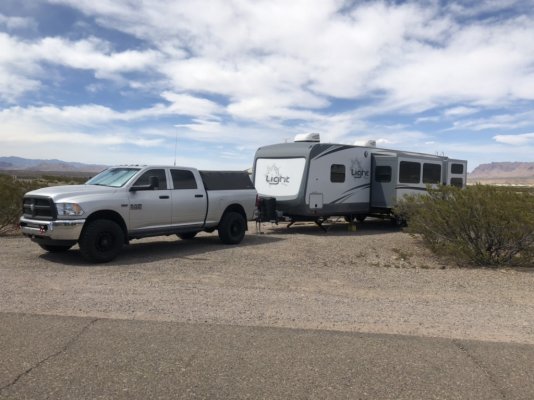

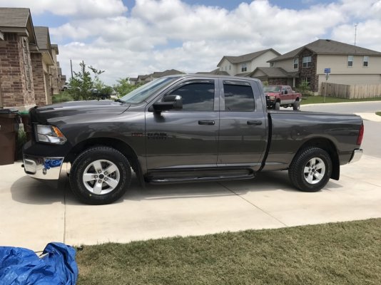

My 2016 QC 4x4 with 3.21s pulled my 26’ Hideout that weighed 7800 lbs loaded, just fine, I never wanted more. When we stepped up to our 38’ Open Range, it was not enough truck, so I upgraded to a 2500HD 6.4.

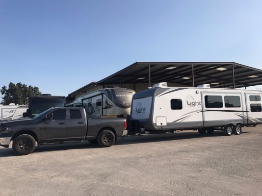

It does, and I can attest to how well it works. Towing this 38’ sail behind my truck across west Texass with a 35mph crosswind, and it held strong.

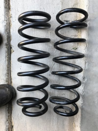

Not sure about those I bought the regular 1223. I also put Bilsteins on my truck at the same time and set them to 2.8”. I thought that was the way it should have come from the factory. And to me it was well worth it in the towing aspect. Much more stable.
https://www.sdtrucksprings.com/index.php?main_page=product_info&products_id=17042
Stock
Bilsteins Only
Bilsteins and 1223 installed
Stock Spring Vs Tuftruck 1223
Let me know if you have more questions, my 1500 was a great truck, and had plenty of motor to pull the bigger trailer, just not heavy enough to deal with the extra weight and length, but handled my 8000lb 26’ just fine, especially after I changed all the stuff out.

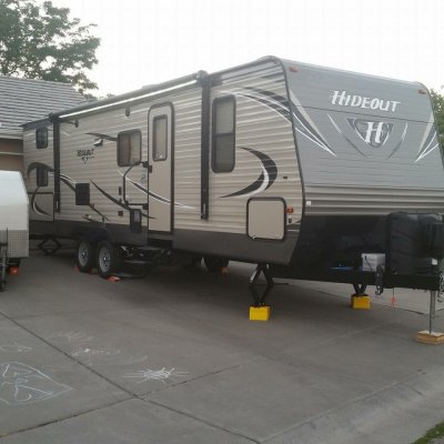

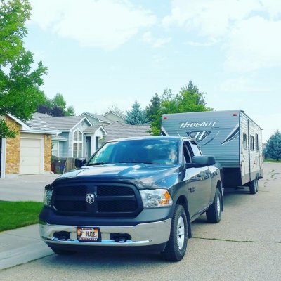

I tow a Keystone Hideout 260 LHS. I use a Curt TruTrak rated for 10k. Works great with Timber Grove ASAM's (air springs). I can back up with the distribution bar locked in. I found out that you kind of have to steer and then let off the turn then back into the turn.
