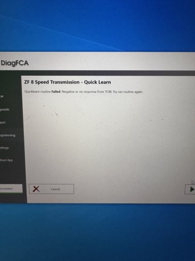

Hey y’all,
Banging my head against the wall with this. Have a 2014 Ram with the ZF 8hp70. Trying to do a quicklearn on it because I’m getting some rough wacky shifts. Tried multiple times with two different scanner tools (Vlinker FS and OBDlink Mx+) and it still won’t perform the quicklearn. I made sure to perform it precisely as described. Fluid temp above 140, battery voltage - everything is as it should be and I keep getting the same error. Using both Appcar DiagFCA AND alfaOBD program.
Thought it might be the aftermarket remote start device but I unplugged that and connected straight to factory OBD port.

Thank you for your reply! Yes, drove it like I stole it and I’m still getting some super harsh and jerky shifts. I know these trucks like to be driven hard and adapt as time goes on but 1st to 2nd up shift is unbelievably rough. Sometimes when accelerating from a coast (around 20-30mph) the whole truck will do a “hiccup” kinda thing. It feels really bad. Def not normal. And it’s only got 120k miles on it.
It shifts silky smooth a lot of the time so that’s what seems to indicate its a software issue.
Changed transmission fluid and filter @ 100k miles. Did multiple drain and fills, following the “lifting the back tires off the ground 9 inches” procedure very carefully.

Hey y’all,
Any input would be greatly appreciated, thank you!View attachment 554563View attachment 554565
Disconnect BOTH battery cables. Get a test light (incandescent) and put it between the cable ends, securely. Leave it for TEN MINUTES ONLY... Reconnect the battery and go drive the truck conservatively for a while (10-15 minutes) then return to your normal driving.
