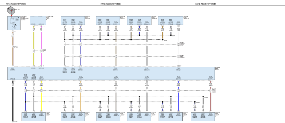

I'm looking for info or help related to the CAN BUS system. I am wondering if I can use the Parking Sensor buttons as a switch? Currently I have my park sense module unplugged and disabled as I installed aftermarket bumpers. So those buttons are not being used. I'm wanting to know if it is possible to use these to run something like aftermarket lights, or another auxiliary relay? Any help is much appreciated. I am pretty ignorant on the CAN BUS system. Thank You

I believe the button module itself has the commands stored so no matter what, when pressed it will send the park sense commands. You can however buy a new switchbank with auxiliary buttons and park sense deleted.
The only way to make this work the way you'd like is to have some sort of CANBUS adapter in between that intercepts the park sense signal and translates it to some custom command you'd want.

That would work. I am struggling to find, if possible, a way to do that. I have the wiring diagram for the module itself.

Was curious if I can somehow use the pink (CAN C +) and yellow (CAN C -).
