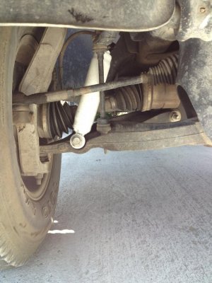

I know you shouldn't have more than a 10% angle on your front cv shafts but i cant lower it anymore and the control arms are after market and have had the torsion bars lowered where they need to be and the front end re aligned. i just don't wanna snap one or both of these this winter going around a corner!
Anyone who can let me know if ill be okay like this please weigh in.

Your way good man. That's not even close to being bad. I've seen some bad angles, and those look fine.
Your at about 13-15% right now. Don't go more than 20-25%. The boots will wear out and the joints will break like any other part. Just inspect them every oil change and you should be fine.
This would be a bad angle and prolly only last a couple months to a year tops, unless they're extremely strong aftermarket CV's.

yeah mine were way worse and they were good

Thats a nasty angle!!
