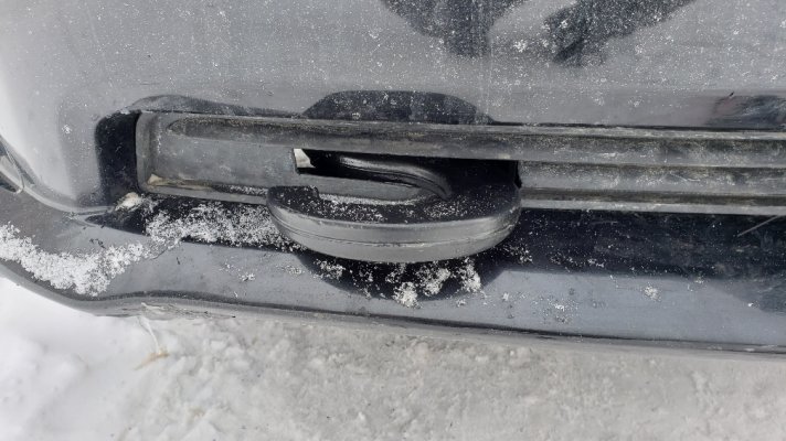

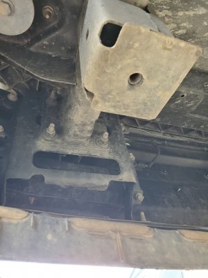

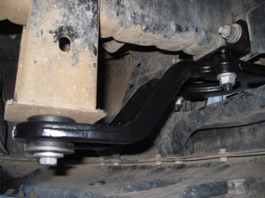

I just did mine and you'll be good... main bolt goes off the frame mount and ull have 2 18mm to bolt to the front where you see the 3 nuts.7f58eeee5ecd43d3f34ab72511554cc9.jpg042ef8d74e899abfddb30a047ed4e6ab.jpg
Sent from my SM-G965W using Tapatalk
Forgive me, but I do not understand where, or what, it bolts to near the piece with the three nuts.

Disregard... It appears as though you just remove the two bottom nuts and install them back over the bracket...

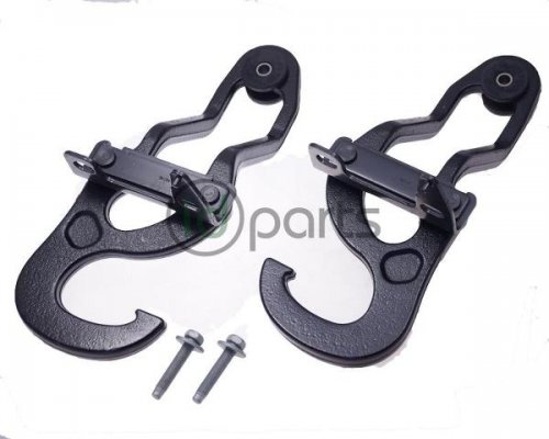

No experience with that website, but that's a bargain.
kurek
Aug 7, 2019
2,662
3,815
Northwest
I'm guessing the website is fine but the hooks are almost definitely reproduction (not OEM) - well part of it is in the way it's worded "replace on OEM.."
The price there isn't too different from Amazon - where they claim to be a reproduction as well.

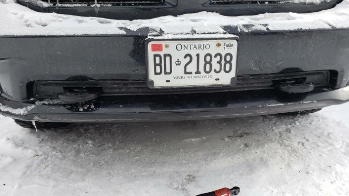

I've read that sometimes they ship the wrong second bracket on aftermarket ones, also the price difference oem vs aftermarket was like 15 bucks in Canada... I paid 200 shipped to the door for 2 hooks and the larger bolts that go to the bottom frame mount. Put them to work a week after yanking out my plow truck after I over extended the plow and hooked it on some really packed snow. They worked great [emoji106]

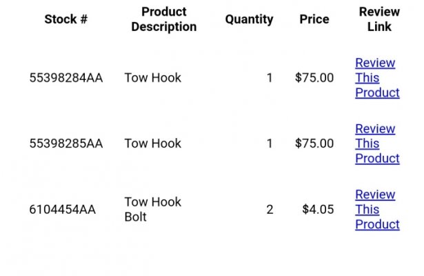

There's 2 ways to buy... 1 part number for the 2 hooks as a kit or else buy them separately per part number as I did... its about 20 bucks cheaper that way after I looked into it. Part numbers and cost in pic below

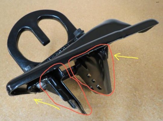

Ram 4th Gen 1500 hooks
The heavy duty tows hooks are quite different & there is more to them than what is in this image
