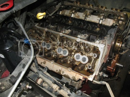

Once you get the valve covers off whith the stock springs
And once you get the heads off
These motors are really simple once you get all the elec off of em. I will be posting more pics once I pull my motor out of the truck.
