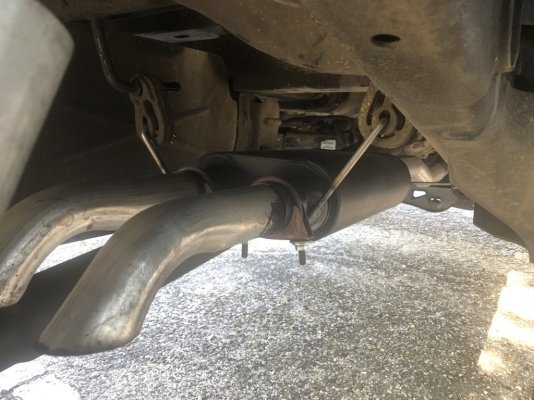

i will take a pic of my turn downs when i get home this evening. will be Thursday before i can upload them. its a single in dual out. sounds wicked.

here ya go, sorry I am late with the pic the radio want shut up and we have been ******* calls all day
Those are factory hanger locations. that's just inside my passenger rear wheel well looking forward, its a super 44 single in into a dual out. That sucker sounds mean with my headers and HO cams. magna flo cats.

Nice! Thanks for the pic - i'll show it to my exhaust guy
