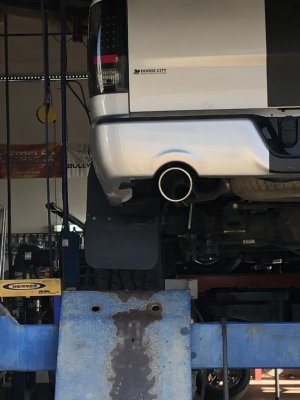

I thought I'd post some pictures of the final setup since I had the truck up in the air to repair the fuel sensor issue. Don't mind the "leaks" as thats all penatrating spray to help loosen the tank bolts. I've recently added 5" tips, removed the resonators and went 2.5" from the mufflers back to finish this off. Don't mind the dirty under carriage as this is Saskatchwan after all! lol

Sweetness! Got some video so we can hear those pipes growling?

Curious on how tame a X-pipe to dual muffler will be with LTs, are you catted or open?
It’s tame since I’ve re-used the factory cat (look up up the transfer case). Without cats this setup would be loud loud and very stinky lol.
