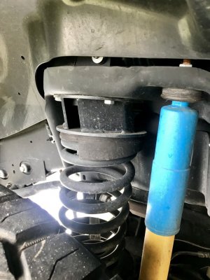

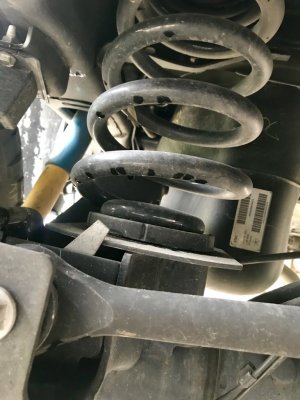

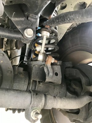

Can somebody with knowledge tell me what I have
Lkw88
Apr 5, 2014
187
25
2005
going on with the lift/level on my truck? It was on it when I bought the truck so not sure what the specs are on it. It looks like just a leveling spacer on the front but I don’t know much about lifts. The first two pictures are of the front suspension and the second two pics are the rear. It’s a 2018 2500 hemi 6.4

Looks an awful lot like the 2.5 Rough Country level for the 2500 to me.

Looks like stock rear and a spacer on the front springs. Look for a spacer at the bottom of the front shocks too.
I would agree might be rough country spacer

Yep. Leveling spacer up front. Stock rear.
Order up thurens kit and get rid of that shet lol

A little on a tangent, but I would have guessed the angle in those spacers would have been slanted to the front, not the back like yours are installed.
Yup, couple pieces of angle welded to round plate, about as cheap as you can get
