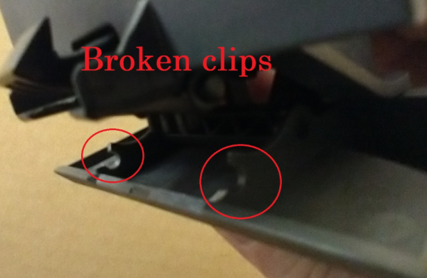

I just replaced my latch. The handle has 4 plastic pins that should pull UP on the lower part. The handle swings OUT, so it put a lot of stress on two of the pins causing the holes in the handle to break. You CAN open the lower part. Just reattach the handle on the two lower pins (you can feel it catch) then carefully pull straight up. Ta-da. Got a replacement from fleabay

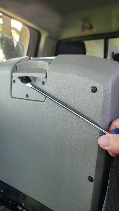

The lower center console storage latch will no longer open the lid on my 2014 Ram Big Horn - the handle squeezes but the latch doesn't release. How do I get into the area to fix it? I can order a new part (latch) but I need to get into the space to replace it. Any ideas will be appreciated. - Thanks
I used a long flat screwdriver to come in from the side and push the latch forward opening the console then put a old envelope to stop it from closing until I fix it.

Huss
Jun 7, 2020
Caledon Ontario
