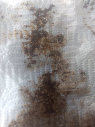

I've had my Ram in multiple times for casting block sand. That is what they keep telling me that's what's causing my problem. On my 3rd heater core. Couple of radiator flushes. 3100 bucks into it. They have had a lawsuit with one of the other vehicles already. And they were told to replace the radiator and the heater core and a engine flush on that particular vehicle. This sand / mud combo does not go away. 130000 miles on my 2014 ram 2500 and it keeps showing up more and more. Didn't have a problem when it was new. Now Ive noticed that going down the road the water pump, pumps adequate water until you come to a stop and the water flow slows way down and the vents go cold. More so on the drivers side than passenger side. They said the heater cores are two different halfs put together? Replaced all motors and blend doors and tested them. Here is the pic from today 3/11/22 that came out of an inline VeLab filter. That they installed before my heater core. It plugged up tight so no flow would run thru the core. It heats fare once you clean it, but its a pain in the ass cleaning all the time. Thats not the permanent fix. They have a problem with crap in there engines. VeLab makes radiator filters to stop any junk from going into it. This is my 3rd ram and I am done buying junk.

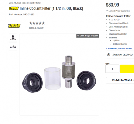

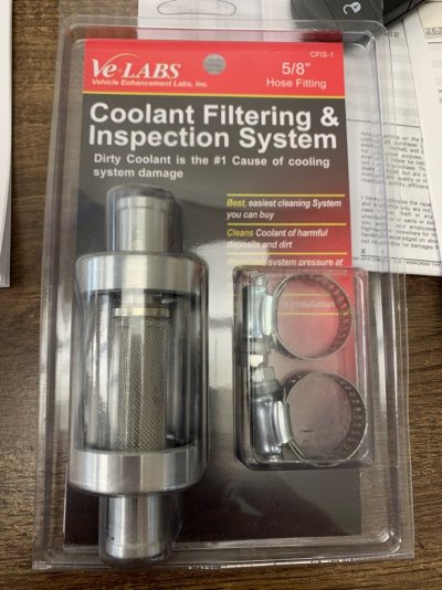

I took my v labs filter off. It’s an every couple of days cleaning if I want to keep using it. What we need is one of these maybe. I haven’t found one online that is rated for 220+ degrees. Having a bowl to spin off and rinse would be much more manageable and would take longer to plug up.

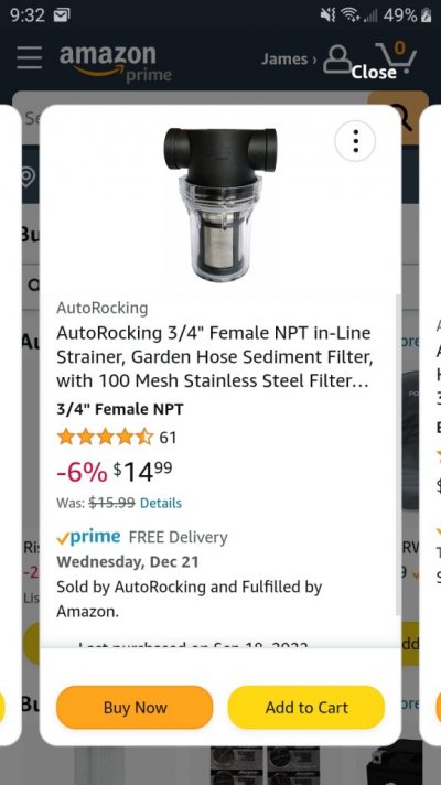

I've considered getting one of these inline filter. My heater core was clogged beginning of winter. I back flushed it and began getting heat but I still think it's clogged a good bit.
I had this same issue with my 2016 Ram 2500 last Winter. My heater core was plugged solid. I backflushed it and all this gritty brown crap came out of the heater core. I bought a cheap inline clear screw off filter from Amazon for around $15.00 and two brass fittings for around $12.00. I cut the intake hose on the heater and installed this inline. Just today I had to clean the screen out again. It was plugged with the fine gritty brown ****. I washed out the screen and my heat is back to normal again. I posted this info up on the FB 4th Gen Ram page with part numbers and pictures.

.here is the filter that I used. The nipples are straight brass 5/8 male with 3/4 npt male end. I'll post a picture of my installed filter tomorrow.
