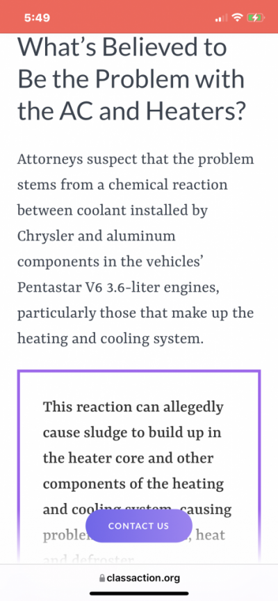

Link sent me to a fake cyber attack screen. It's actually a scam attempting to get users to contact them to pressure you. I've seen this one before.
Here’s a couple other screenshots involving other claims for the same general problem:

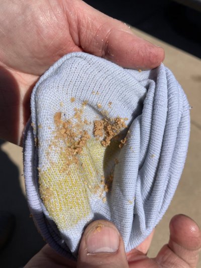

I can't confirm casting sand, just clogged. The casting sand thing has been circulating for many many years but I'm not sure if it is still an issue or if it is something else? I can say I did not see any sand come out of mine nor have I seen anyone with a clogged core get sand out of one. It's usually particles of random stuff (some grey iron) and other crap and goo.
I'm not sure if coolant sitting in the bottom and small passages of the core are just letting sediment and crap clog it up over time or what?
This is what came out of mine and there was no evidence of anything else in it. Vent temp went from lukewarm to 170* after I back flushed it and I’ve had the same results each time. I’ve back flushed it 6 times in 2 years. The problem started after I changed my thermostat, then a couple weeks later had to change my radiator. Coolant only has about 35k on it because it was totally changed out during both repairs. Those particles look like a coating that is breaking loose (not plastic I checked by heating) but if I rub them between my thumb and finger they turn to something like dust. Makes me think it might be remnant casting sand dust.
That does not look like what came out of mine, but that definitely looks like some sort of sand.

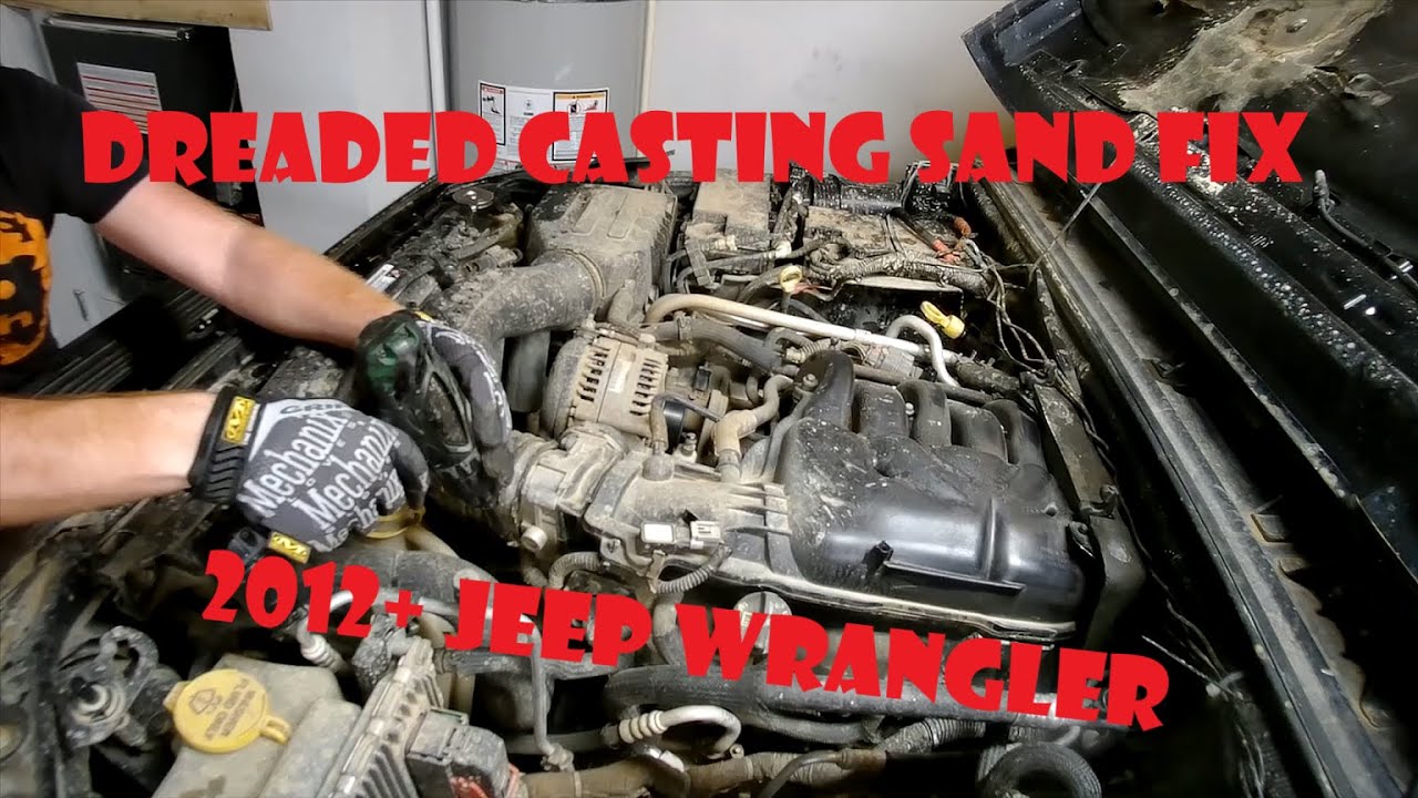

The JEEP 3.6 problem the earlier website link explains the casting sand is from the cylinder heads not the engine block.
What is unusual about this claim is sand only in the coolant passages and not in the oil passages which would be more logical, the sand represented in the photos looks like a clay color sand that is tan possibly a quarts based sand that has been exposed to oxidized iron filings from the heater core ?
Most imperfections in aluminum castings are not just in coolant passages, but throughout the entire interior surface and resemble thin superficial sheets of aluminum.
Sand could be caught inside between the sheets and cast surface but a substantial amount of aluminum would be present also.
In this youtube video the explanation from a member of the JEEP 3.6 community is the cooling system replacement is the only cure .

I was getting too many mystery flakes with mine so I took it off a couple hours ago. It definitely works but my system is way too contaminated for it. I’m wondering now if maybe it’s cooked coolant from the egr cooler that is breaking free from the walls. It’s like a bunch of well defined flakes. It turns to powder if you rub it.
ripping r
Old&Grumpy
Jun 15, 2018
510
468
earth
6.4 HEMI
you have some big chunks. no way those went through the water pump. or the tstat. if its coolant could one put some in a pan and boil it to see if it does the same in the pan?
