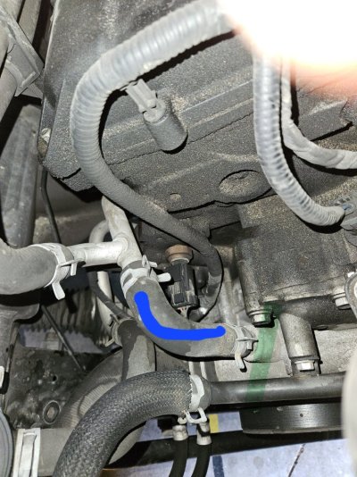

@Wild one, Standing here, in front of the beast, ready to do some flushing, had more questions about hose routing, etc.
There a line on the left side of the water pump that feeds one end of an aluminum tee. The branch of the tee goes to the bottom hose of the heater core at the firewall.
The other end of the tee goes to the transmission? The line from the transmission? goes to the side connection on the 3-way valve
Can/should the trans lines be flushed with air, or safer for me just to fill coolant and go from there?
The metal line near the water pump outlet goes to the front side of the 3-way valve, and the line at the rear of the 3-way valve goes to the top heater core fitting.
Just trying to get an idea of how coolant flows in the truck.

Blowing them out with air will get alot of the old coolant out,but doesn't do much for removing any crud/sand etc from the heater core,but it's better then nothing though. To remove the build-up in a heater core,you need a liquid flushing median and about 15 to 20 psi of pressure behind it

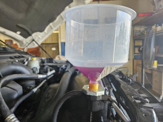

Well, undid the bleeder screw, filled her up with coolant, closed the bleeder, topped her off, kicked the heat to high and let her rip.
Took FOREVER to get near 203°, and my top hose was dead cold. Wasn't paying attention, and noticed my funnel was about to overflow. Shut her off.....
Too late.
Overflowed a little bit. Great. Was trying to be careful. Ed luck. I didn't think the OE stat was ever gonna open, then the top hose got hot. Took a while to get were it seemed like all the air was out.
Noticed when I'd see the bubbles come up in the funnel, my evic would be reading 206°. Not sure if the sensor might be weak or what.
My condenser fan seems like it runs ok as well, and I did see the temp drop to 195° as well, so it looks ok.
Gonna take her for a spin, maybe later.
Thank you to everyone for the advice and moral support.

now that is professional where did you get that set up?
sometimes the small things make maintenance fun.
OEM tools brand from Amazon, was only like $20 I think.
I had some small leaks at the cap until I got it on the right way.
Now I have the smell of coolant because it spilled down the radiator....lol
Ed luck
Too late.
I've had this happen a couple times when changing tstats. A bubble will form right near the temp sensor and just enough around the tstat so it doesn't open. Even when using the bleeder plug.
I've found you have to rev it to 1500rpm for a few minutes when its almost to 203⁰ to force that bubble through the jiggle pin. Then the tstat opens and everything starts bleeding fully.
And yeah that funnel is so worth every penny!
I've used that on multiple vehicles
That's good to know, cause it kinda scared me. This truck is my baby.
A little bit down the road, I might just preemptively do multiple drain and fills with distilled water only, then fill with straight concentrate.
I tried to remove my lower radiator hose today before I filled it, and could not pull that sucker all the way off, I finally said screw it and just filled it up.
Yeah I hear you, it scared me the first time it happened. And fun fact the temp sensor does NOT read air correctly because once the bubble went thru the jiggle pin the temp on the EVIC went from 189 to 225 in about 2 seconds.
Scared the sh it out of me lol
Multiple drain and fills will do the exact same thing it will just take longer. The block drain even on the passengers side is a pain to get to and theres no way it's not going to make a mess.
