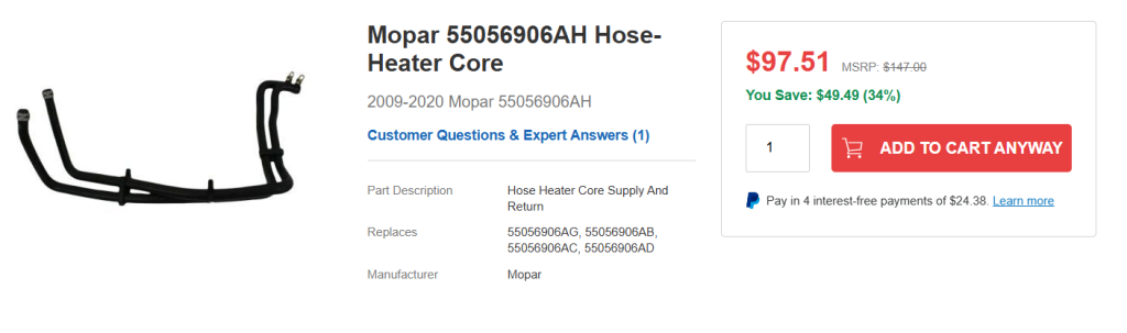

Is it the heater core hoses your looking for?
I found them for my 2013, i wonder if they are different for a 2015
Availability will probably be good for awhile. It shows to be the same part for all the trucks up to 2020, and probably the "Ram Classics" as well.
I've also seen "Gates" branded aftermarket molded hoses from O'Reilly Auto Parts as well.
Those are for the RFE 5/6 speed trucks,the 8 speed heater hoses are differant,as they route coolant to the thermal management unit on the side of the 8 speed to pre-heat the transmission fluid. When i deleted the TMU off my 8 speed,i went back to the simpler heater hose routing,but left the 3 way valve plugged in.
If you're bored tonight Ken,here's some reading on how Khris/CrazyKid and i deleted the thermal management unit. Only the 1500's preheat the 8 speeds fluid,the HD trucks and cars don't preheat the transmission fluid.The heavy duty trucks also use a lower temp transmission thermostat then the 1500's do,the HDs usually run between 160F and 168f when towing and right around 160F if they're running down the road unloaded

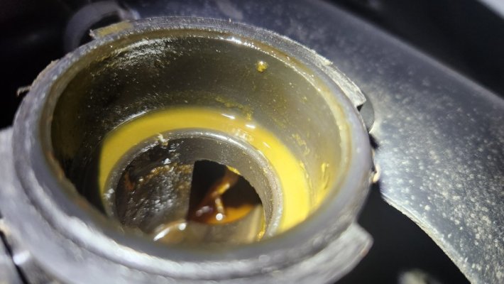

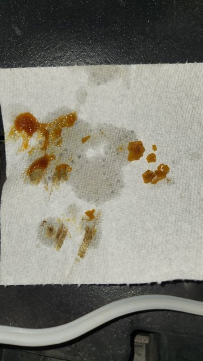

I came here last week to read up on doing the coolant flush and came across the posts about the RMI 25.... Yep it works, only a couple hundred miles... Lots of sludge in the overflow as well.

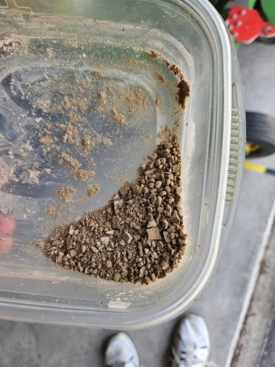

Well, I finally checked the container that I had some of the 'sand' in it. The coolant finally dried up, and it looked like a dry riverbed.
I broke it up with my fingers, here is the result. Looks like sand to me.
Jan 17, 2016
23,817
54,819
14 Sport
Damn that's enough to start building a sand castle with,lol. And we wonder why Chryco products have issues with cooling systems and heater cores :rolleyes:
