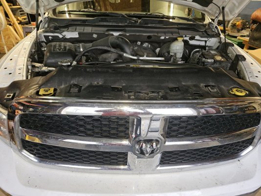

Ken said he had to lightly file them to fit, I filed them too heavy, and they were loose.....lol. So I only have 2 left.
You will have to remove the top inner trim from the inside of the grille, there's like 8 or 10 screws, 9mm.
The 2 bottom clips, I stuck a small flat screwdriver in to bend the locking clips, then I could lift it enough to clip it apart to remove it.
I might just order another package, just in case
Out of 4, I had to use the file on 2.
And only 2 or 3 strokes each tab, with a tiny pattern file.
