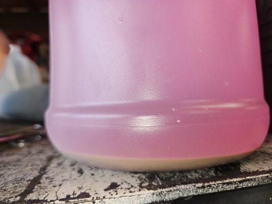

I would think it was a result of mixing the wrong coolants in Rams - google it - rather than sand.
Nope, really don't think so, got the truck in Sept. of 2017 with 28k miles on her, have only used Mopar OAT and distilled water.
Changed coolant at 108k miles on Dec. of 2020. Has 196k miles now.
Unless improper coolant was in it to begin with, but I doubt it.

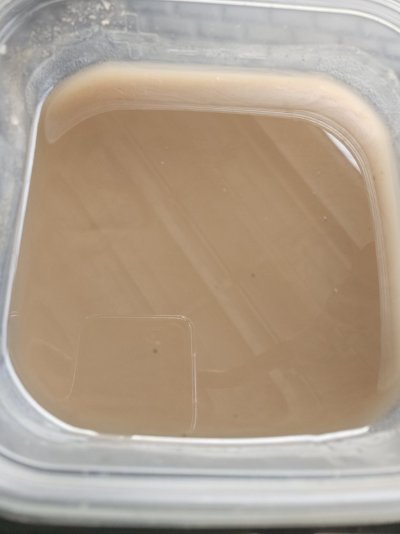

if anything what we have been seeing over and over is 10 years is too long. I'd be on a 3 year interval if it were me on a new truck. My truck is 15, I do coolant drain and fills every summer.

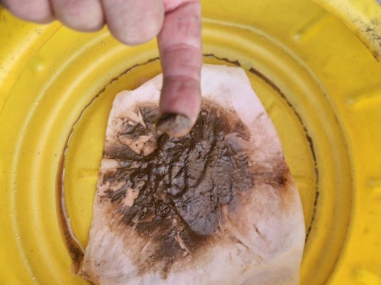

thanks Ed good pics.
Now that I know what is/was in there, hopefully I can get it out, and see what is found from here.
Only unknown is, how do I know it's all out of there? I really don't want to add any 'flush' for fear of causing additional grief.
CLR is pretty good stuff, I would trust that over flush products.

Ed here's another thread with pictures of the sand that came out with a flush.

I believe I will just keep running distilled water through it to flush it out, esp since I have a new radiator.
I have not had a problem with getting heat in the truck, nor has the coolant been exposed to freezing temperatures here in SWFL, maybe mid-30's, and that's only a few nights per year.
I have noticed that I have no airflow in my far right passenger side dash vent, and that the little damper knobs have no effect on air flow in ANY of my dash vents. That has been an issue since I've had the truck, I have no desire to take the dash apart unless I absolutely have to.
I am hopeful that I can get most of the crud out of the system. I might do something with the old radiator to see if any grit is in there.
