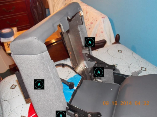

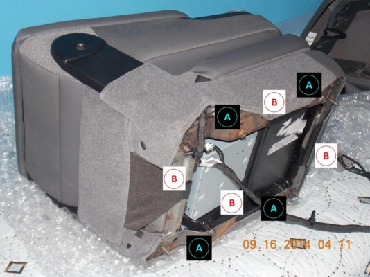

Removing the CD player itself will not give you any more storage room, you will also need to remove and replace or modify the lower tray as well. You probably don't want to hear this but the best way to do this is to remove the bucket seats from the truck. Remember to discharge the airbags by disconnecting the battery for several minutes first. The reason is in order to remove the CD player and tray you need to access 8 bolts (item A) that hold the tray in, four of them require partial removal of the upholstery by unhooking plastic clips (item B) for access. These four are located on the sides of the jump-seat. The other four are removed from the top inside the storage tray. You may be able to do this without removing buckets but I would not, it’s much easier with buckets out. I found this out by going the opposite way I wanted to add the CD player. I found one in a new jump-seat on ebay, but I had to change the upholstery on it first, so I know how it comes apart. Once all screws are out tilt tray toward back and lift off hinges, unplug harness from CD player and install new or modified tray. I switched the upholstery, removed all three seats and installed new jump-seat and put original buckets back in about 4 hours. This should take you about 2 hours give or take.
