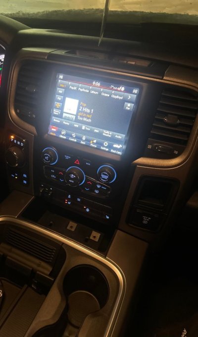

I did the center console swap inside of my '21 Ram 1500 Classic. I got the center console from a junkyard and it came with the media bezel and the console trim as well.
Ever since I installed the console there's been a gap on the right side where the two bezels connect but I actually assumed it was the bezel potentially being warped.
I purchased some new bezels (the bezels I got were scratched, damaged, so wanted new ones anyways) and the gap still seems to be here.
I want to say I made sure all the pressure clips are in on both of the bezels and I've refit it multiple times. Is there something I'm missing? The truck is not old, not like there's an issue with the frame being bent.

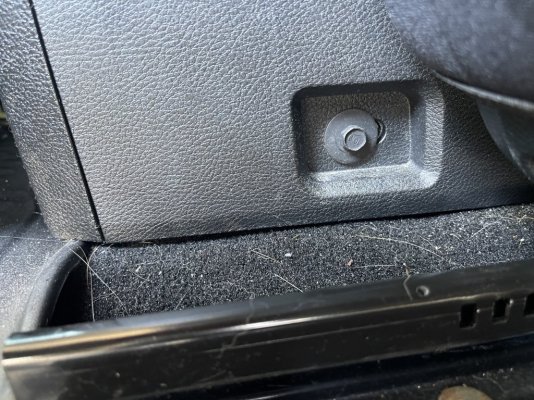

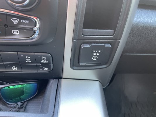

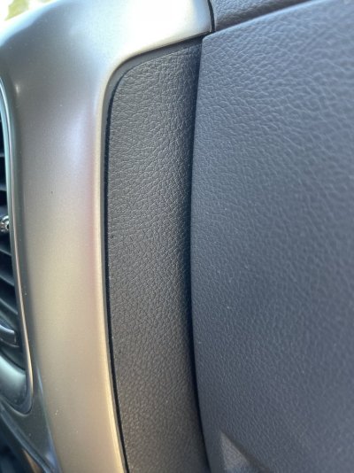

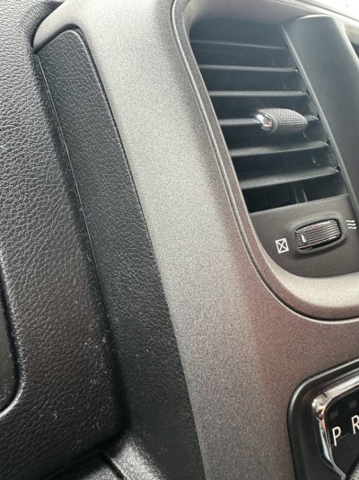

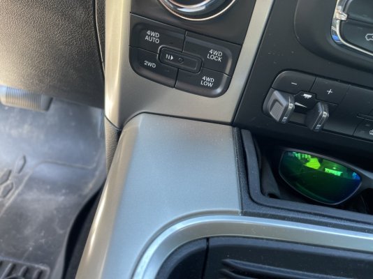

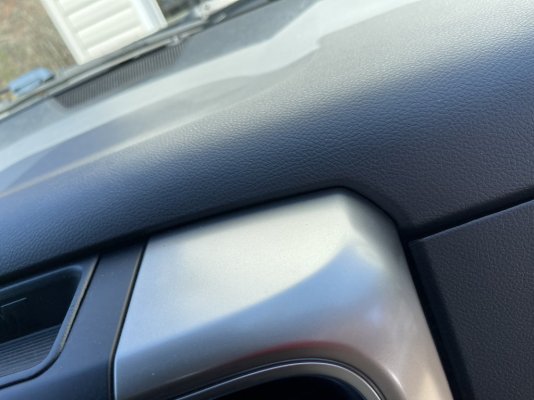

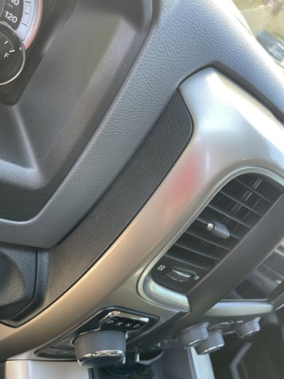

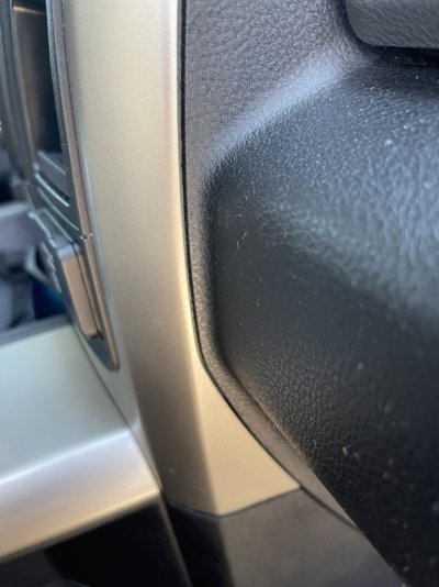

Here are the pics. Don’t look too much different from yours. The last pic is one of the center console mounting screws hidden behind the passenger seat. You can see from the pic there is an oblong slot in the console to allow for forward/backward adjustment. I’m sticking with the misalignment is in the floor console.
Yeah our bezels are similar, yours still fits slightly nicer than mine. I did try moving with the console again (I have the same holes) but can't really get much improvement at all out of it. I guess I'll just say screw it for now.
