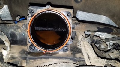

changed my plugs today. first of all, what a pain lol (the drives side back set). had 2 boots rip off inside the tube. Quite a few were barely more than hand tight, one plug WAS hand tight. Most looked fine. 6 on the drivers side did not. They had a orange/rust tint on the porcelain area by the electrode. Posting pictures... please let me know what you think it is.
Also... the crankcase vent tube has a NASTY amount of oil/gunk buildup (the air filter had a lot of gunk in it from what Im assuming is the crankcase vent as well, which went into the intake/tb etc). . Also changed the pcv, which was nasty and old. The TB was very dirty, VERY VERY dirty on the inside (i had cleaned the outside before quickly). Any idea what that is or is from? Should I change the crankcase breather to a filter instead so Im not sucking up all that gunk/crap or whatever it is?
I did NOT clean inside the manifold, didnt want to go that indepth or get stuff inside the engine.

Sounds like a lot of lack of maintenance from the previous owner there.
Get yourself some Taylor plug wires, either the shorties or the normal ones. I know you already changed the plugs but I highly recommend using anti seize on the threads and a dab of dielectric grease in the boots to prevent the issues you had.
Crank vent tube going into the airbox should be coming out of the oil fill thingy. Yes, you can run just a small filter off that and be fine, just plug the opening on the air box lid. The crap from that vent is what causes the TB to be so dirty. If you leave it as is, you need to clean the TB about every 20k miles in my experience.

I will do that then. Dont like having that junk sucked into the motor at alllll. I dont mind a dirty tb, but what was in the intake manifold is what got me (looked like a orangeish solidified stream of just gunk/crap).
Yea, I figured lack of maintenance as well. It has 204k miles on it also.

Thanks for the 'advanced' tip. I was able to. had to significantly shrink the picture haha.

Oh Man, that TB looks NASTY!
I've got an intake off an '04 Ram 5.7, if you're interested just shoot me a PM.

Once you get it all buttoned back up your engine could seriously use a dose of seafoam to deal with all that buildup because your pistons, upper cylinder, and valves will look the same. The intake on my '07 looked like that as well but a couple of runs with seafoam made a huge difference to both performance and mileage. A lot of that buildup is also from the EGR mixing with the crankcase vapours from the PCV. If you want to keep the EGR then you should also pull the tube and soak with seafoam, you'd be amazed at how much carbon builds up in there and constricts the flow.
