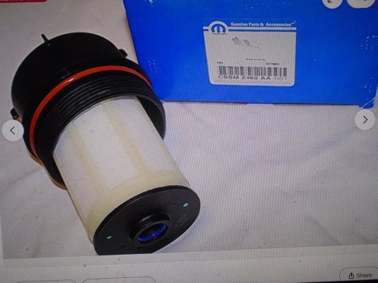

For this round, I decided to let the dealer figure it out and swap the filter. Their parts guy was the only one in the know and found the right filter. For those interested, it is CSSMZ462AA. No idea what is different about it vs the old. Maybe higher micron rating? Would love to know.
06 Dodge
Jan 4, 2022
2,916
3,546
Forest Grove, Oregon / Osage Iowa
6.7L CTD
Below is a photo of the filter, was surprised I could only find a photo of it on Ebay, also noticed on the box it shows it was made in Korea :rolleyes:

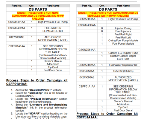

So this is what Mopar says on this
If Safety Recall Z46 has not been completed, use 68235275AB
If Safety Recall Z46 has been completed, use 68632011AA
CSSMZ462AA Filter would be the updated version that is used in the recall and would be the equivalent of 68632011AA, These are generally not to be sold retail by dealers.

Yes they are probably pulling them for use in the recalls. I did not read all 50 pages of the recall to see if there are clues as to the filter differences but I can post the recall here if you would like.

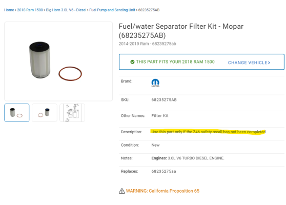

Just ran into this issue for the first time and figured I’d post to let others know my experience. Dealer told me same thing today…my 2018 Ram Eco needs the new part number filter because it had the HPFP recall done. New filter is unobtainable and no idea when it will be available. I was told the old part number filter wouldn’t fit and parts counter refused to sell it to me (even though they had it in stock).
TLDR 68235275AB fits just fine and has worked just fine for the 40K miles since my Z46 recall was done.
I was skeptical of what the parts guy told me because my recall was done 2 years and 40K miles ago and this has never come up before so went home and looked at my records.
4/23/24 and 39,663 miles: Z46 recall done and CSSMZ462AA installed per invoice
11/3/24 and 49,670 miles: I performed routine service and replaced fuel filter with 68235275AB
3/22/25 and 59,563 miles: I performed routine service and replaced fuel filter with 68235275AB
10/11/25 and 69,088 miles: I performed routine service and replaced fuel filter with 68235275AB
Today I’m due for 80K mile service and first time this “new” filter is brought to my attention. Based on the above history I went back to the dealer and told them to sell me the 68235275AB. It required getting a manager involved and them putting a “note in my file” but I walked out of the dealer with a filter, installed it this afternoon.
Anyway, can’t comment on what the difference is between the two part numbers but the “old” one fits and works just fine. You might just have to fight for them to sell you one.
