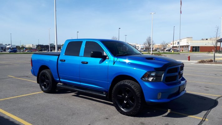

Here's my 19' with front and rear 5100 Bilstein's with the front set at 2.1" raised and no rear height enhancements, and all sitting on the stock factory springs, and stock UCA's.
I'm rolling on BFG KO2 LT285/65R20's, and still have a slight rake because I tow and haul periodically.
I've had this set up since shortly after I purchased new in June 19' and no issues. Perfect ride quality with excellent handling and control characteristics.
This is a perfect set up and stance, and the little extra height from the taller tires is a nice bonus. The wheels fit the wells great and the tires just poke out a little giving it a nice head on look and stance.
