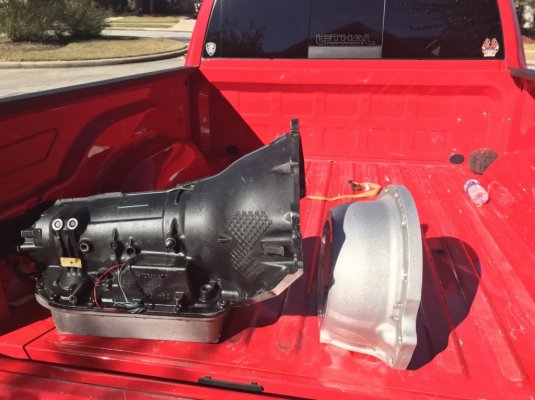

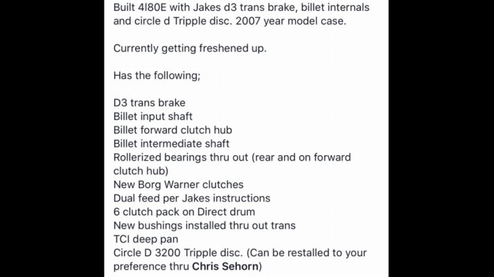

Just purchased my 4l80 from a friend that had 800 mike and got it refreshed for me with new clutches and all. This is supposed to handle 1000 rwhp so I hope I don’t have to deal with transmission issue for a good while with this build.

The built 4L80 has came home, but now have to take it to get the new bellhousing machined on. Then I’ll be able to install it behind the 468 hemi

Looks great! How much effort is the swap compared to a dodge trans?
So far it doesn’t look difficult, but of course all I’ve done was get the 4l80 built and about to drop off the transmission and tied bellhouse off to get machined into the transmission. Then I’ll take the whole truck to get a custom crossmember and get the driveshaft measured for a custom one.
