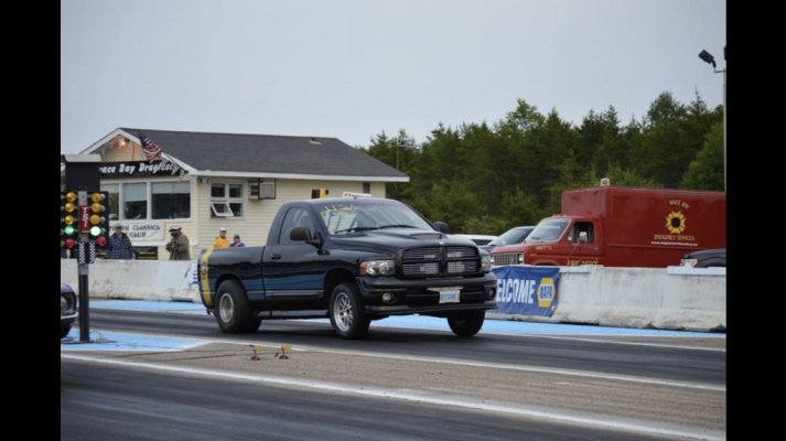

Check out my new Aluminum 468 for my Daytona
