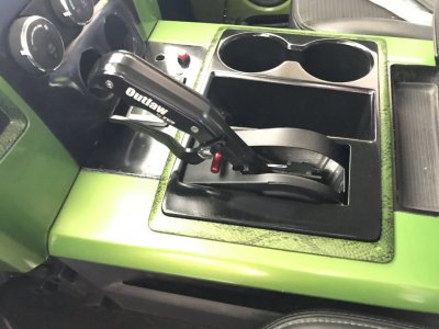

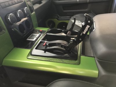

I liked the Outlaw enough to get it for my swap. I should think you can get away with a 1 piece but I was curious if you had done any measurements yet.
U have pic of it installed? I think your the guy CHRIS is talking about when he helped me with the info for the 4l80. I plan on doing the measurments when I take it to get the custom crossmember made
charonblk07
Mar 14, 2013
4,056
2,089
Calgary, Ab
2009
F1-A forged 349ci
Chris' been bugging me about my swap for a while so he was happy when I did the how-to.
http://www.ramforum.com/threads/how-to-4th-gen-ram-gm-transmission-4l80e-swap.112665/
You should be able to just modify your factory trans crossmember, I used an old notch kit I had laying around welded onto the factory member and it worked perfectly. My driveshaft length ended up being 84" long with the quad cab, the reg cab is ~16" shorter so you may be able to get away with one but you'd need to be sure the material used will handle the critical speed if you decide to run a short set of tires.
