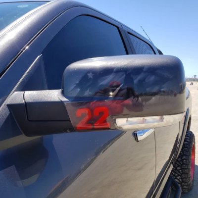

I did mine just sand down the chrome to take the gloss off it and paint them reseal with clear coat AND get plastic film (clear) and cover2ab1bc8dc470eceeb260103b5e00a2f1.jpg83b1db4f2dfb1b1b7def082bdf29df69.jpg

It’s very easy actually, just pop off the mirror glass. Behind it you’ll find 3 torches screws, once removed you’ll unplug the turn signal and the chrome covers are off!
The glass can be tricky just YouTube a video on how to replace it and you’ll see just how easy it is.
