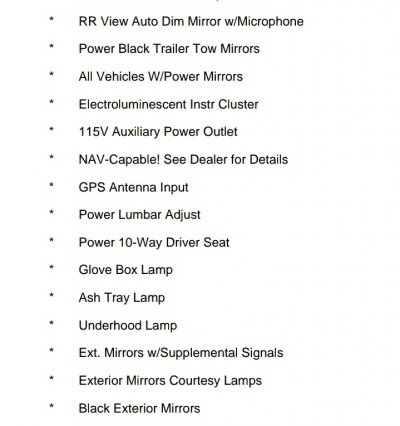

Here's the build sheet link for your 14ram1500 ...
http://www.ramtrucks.com/webselfservice/BuildSheetServlet?vin=1C6RR6LG9ES196323
And screen shot...
So it's not exactly the dealers fault... The 13-14, & maybe 2015 TOW mirrors with autodim, supplemental signals (& puddle lights) did not have power fold as an option until later, 2016+ think.
Someone likely swapped out the mirrors at some point, along with the switch & door modules to support power fold. Enabled the codes with AlfaOBD or OBDgenie and went on their way before trading in the truck (it's an LA, California truck per build sheet).
Once the dealer flashes the BCM config for an unrelated recall... It resets the other settings to their factory default config (no power fold) and disabled it. As discussed you can enable it yourself with AlfaOBD or have the dealer flash/add the related power fold sales code ( LER ) so it stays during the next recall/BCM flash
Related thread...
- DIY: 2013-18 (19 classic) Power Fold Mirror upgrade/Notes.
Mirror Related sales codes:
GNZP Auto Dim Exterior Mirror
GN5P RR View Auto Dim Mirror w/Microphone
GUKP Power Heated Mirrors, Fold-Away
GVBC All Vehicles W/Power Mirrors
LEBP Ext. Mirrors w/Supplemental Signals
LECP Exterior Mirrors Courtesy Lamps
LERP Power-Folding Mirrors
LEUP Auto Dim Exterior Passenger Mirror
NHJP Exterior Mirrors w/Heating Element
** Note: I'm not sure what the Tow mirror sales code is so that the adjustment switch works correctly when in the up position ?? (If someone knows, let me know) **

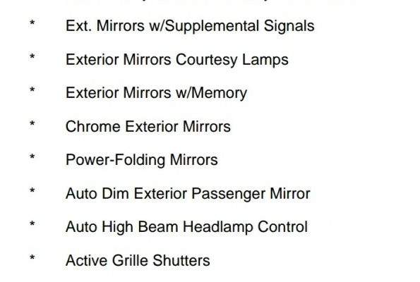

EDIT: AS a comparison here's my 1500 (STD size Laramie power fold mirrors)

Here's the build sheet link...
And screen shot...
Related thread...
M² Mods.

Just curious... Does your build sheet show the power fold option (the OP's unfortunately doesn't, hence the dealer problems).
copy the above link and then paste into a web browser address bar, add your vin# to the end (no spaces), after the "=" hit Enter.
AS a comparison here's a snip of my 18 1500 build sheet (STD size Laramie power fold mirrors)
