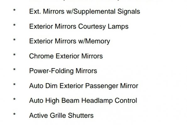

Just curious... Does your build sheet show the power fold option (the OP's unfortunately doesn't, hence the dealer problems).
http://www.ramtrucks.com/webselfservice/BuildSheetServlet?vin=
copy the above link and then paste into a web browser address bar, add your vin# to the end (no spaces), after the "=" hit Enter.
AS a comparison here's a snip of my 18 1500 build sheet (STD size Laramie power fold mirrors)

Sorry for the delay, but yes, my build sheet showed the following regarding side mirrors -
  • Mirrors-Tow Pwr Adj/Fold/Heat Black
  • Ext. Mirrors w/Supplemental Signals
  • Exterior Mirrors Courtesy Lamps
  • Trailer Tow Mirrors
  • Power-Folding Mirrors
  • Black MIC Exterior Mirrors
