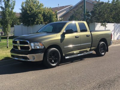

i just got the Mothers Speed Clay 2.0 to try on the truck.
Pull Ya
Jan 16, 2012
16,055
23,882
Cedar Creek, Tx
^^^^ Wolfgang has excellent products!! Truck looks really great.
