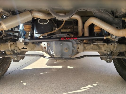

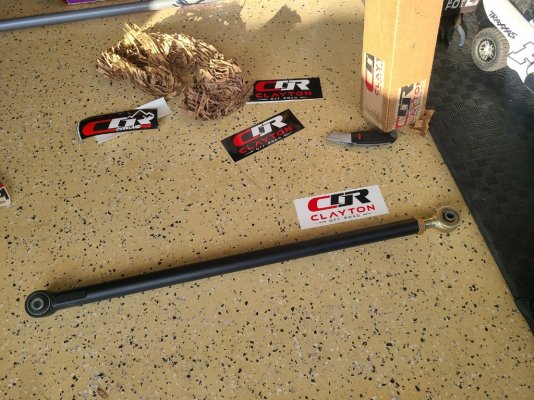

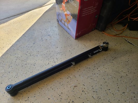

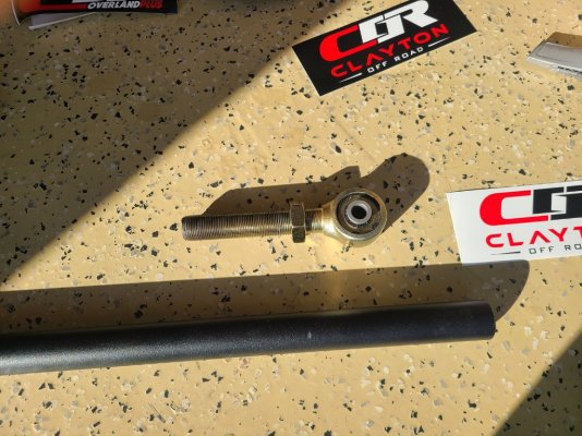

Another gem from the Jeep 2020 Gladiator market, and another direct fit to the 4th gen RAM 1500 since FCA shared rear control arms and rear panhards from the 4th gen RAM 1500 to the Jeep Gladiator platform. Clayton part# COR-4510110
Specs on the panhard are 1 3/8 x 5/16 dom tubing, then a Giiro bushing on one side, and a 5" long Johnny Joint on the adjuster side, and just like the Clayton rear control arms i'm running, Clayton Rear control arms and trackbars carry a lifetime, no questions asked warranty against bending or breaking.

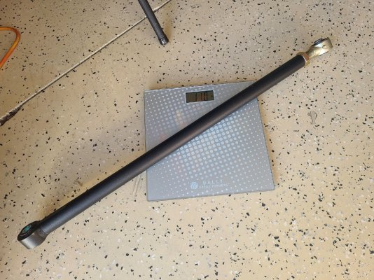

The bar is pure beef, at checks in at 11lbs
50705908733_553c14055d_h.jpg20201211_081530 by RAM RSM, on Flickr
50706769567_29c18d6c27_h.jpg2020-12-11_09-13-11 by RAM RSM, on Flickr
50706645891_06d595aa94_h.jpg2020-12-11_09-00-25 by RAM RSM, on Flickr
Setting it up at the right lenght as my FO panhard
50707304137_fe4fcf4c1d_h.jpg2020-12-11_12-15-26 by RAM RSM, on Flickr
And mounted
50707222506_56cff7fe24_h.jpg2020-12-11_12-15-46 by RAM RSM, on Flickr

ok, should that be parallel to the ground or not? Asking for a friend

The more parallel the better. The way that angle looks now is more than fine in my case so i haven't done anything about it in 2 years and change. I bought the Carli bracket a few weeks ago and sold it to a member here cause i wasn't motivated enough to remove my welded exhaust legs in the back to drill the mount :)

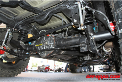

Regarding the angle of my current panhard bar. Looks no different that a 4th gen Stock Rebel which are 1" taller than my Express for example in factory trim. i'm lifted 1.5" and have been running around 1-1.5" lift in the back for 2.5 years without a single issue.
http://www.trucktrend.com/features/1508-first-drive-2015-ram-1500-rebel#photo-19
Likewise seems the same panhard angle as the TRX concept
https://www.off-road.com/trucks-4x4...-about-ram-rebel-trx-concept-truck-54534.html
If the panhard angle was good for the Rebel or for the TRX even with a little angle then it's good for me :), but again, the more parallel you run the best the rear should handle.
I know Carli sold the concept of the bracket and it's not that expensive if you want to have it, in my case i'm lifted 1.5" and there is zero need for me for any correction other than to recenter the axel. I run the truck loaded to the roof (anywhere between 800lbs to 1500-1600lsb in the back of the truck ) when we go out for vacations and what not so that bar will go a little more level anyways under those circumstances.

Found a place up here that carries them :)

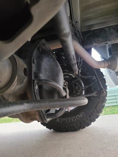

Thanks dude just ordered it. Plenty of room :)
The G2 is just a tab bigger over OEM

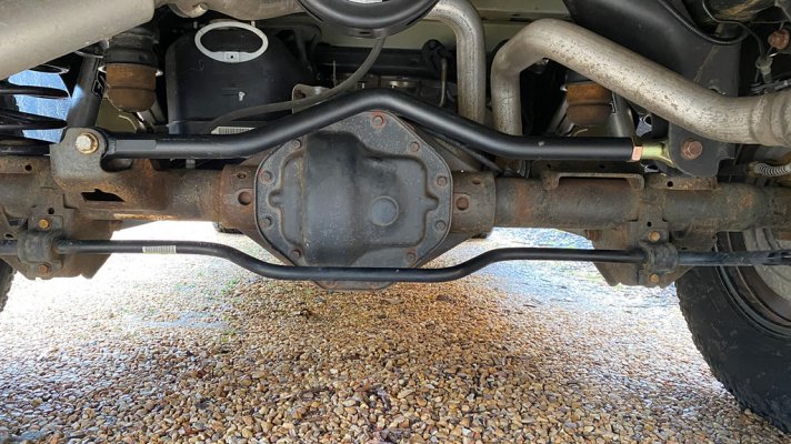

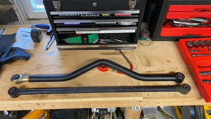

Is COR-4510110 discontinued? I was able to find it on a few websites, but not on Claytons. It looks like the only one they have is bent to account for the rear spare tire.
RVA Ram
Mar 15, 2017
72
55
Richmond, VA
I ordered the COR-4510110, but ended up getting sent the COR-4510120 which is bent. Does anyone know if the bent version will fit? I can run out and check but the weather has been awful and under the truck is all mud.
*EDIT: Thinking a bit more...it may work if the bar is flipped so the hump is upside down facing backwards instead of forward. I'm not running the spare under the bed. This may also make more room for the diff cover. It does look like the mounting points for the Gladiator are up higher than the 4th Gen ram.
One last question: The clayton bar and stock gladiator track bars use 90 ft-lbs for torque. Should we use that spec or stick with the 200 ft-lbs for our trucks?

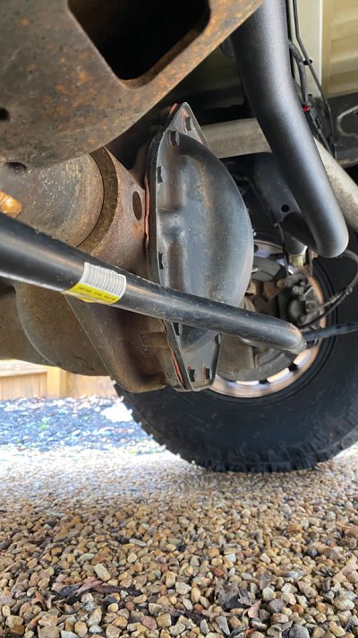

Well I couldn't wait. Truck is currently sitting on stock springs, sway and Fox 2.0's. Thoughts? Should I keep it? If so is upside-down ok?
Here's the Clayton COR-4510120 track bar installed in the Gladiator orientation:
Stock length is perfect fully compressed. I added one turn to help tighten the nut.

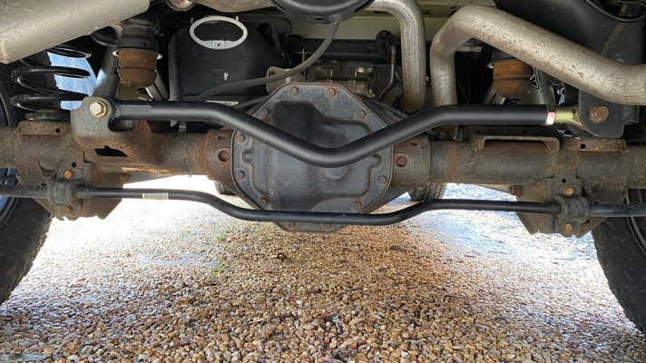

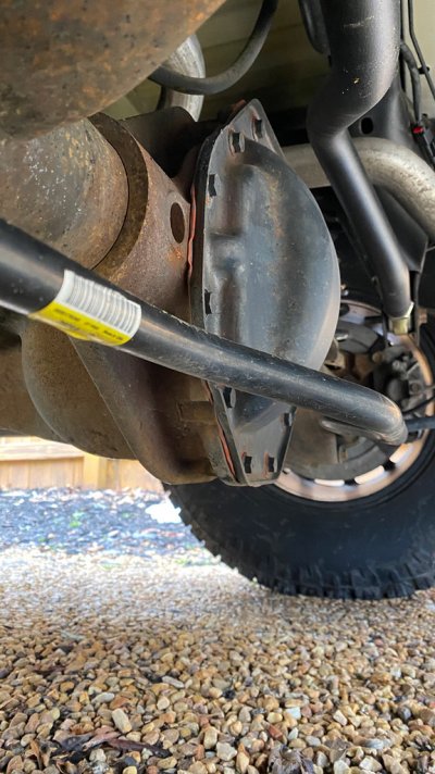

Here it is installed upside-down:
Lots of extra room upside-down

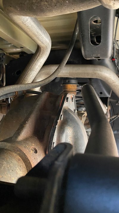

It seems they changed the design couple of weeks ago, i see a post in the Gladiator forums dated 01/26/21 that says they're now making the bent version the primary one in all their kits for the JT. Hoping they didn't discontinue the straight version, they should offer both :)
I tought about the bent one for you guys with the alum bigger diff covers but from Dilligaf pic it seems the straight one will fit.
I'm using 100ft/lbs in mine, this is my 3rd panhard now and i've always used 100. 200 will be too much for those bolts. 200 is for the control arms.
Up looks better. Have you tried contacting Clayton and see if they're not making the straight one anymore ?

Up does look way better , If you flip it 180 doesthe bend center more on the diff ?
