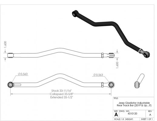

It seems they changed the design couple of weeks ago, i see a post in the Gladiator forums dated 01/26/21 that says they're now making the bent version the primary one in all their kits for the JT. Hoping they didn't discontinue the straight version, they should offer both :)
I tought about the bent one for you guys with the alum bigger diff covers but from Dilligaf pic it seems the straight one will fit.
I'm using 100ft/lbs in mine, this is my 3rd panhard now and i've always used 100. 200 will be too much for those bolts. 200 is for the control arms.

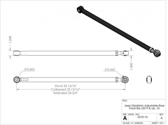

Thanks, I ended up using 100 ft-lbs, 200 just seemed way too much. I found another thread that said factory spec is 114 ft-lbs for the 1500. I'll probably shoot Clayton a note and see if they still have the straight versions. The drawings for both parts from Clayton do have different dimensions which is kind of odd.

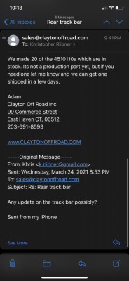

I emailed Clayton today and it's official they have discontinued the straight version and now only sell the one with the bent.
There are other options as well that are also quality in the same price range with JJ bushing on one side and a flex bushing on the other that are straight.
Rockjock RJ-150400-105
EVO EVO-3049B
Icon now have one that can be adjusted while mounted, Icon IVD22068 , little more expensive of course.

Haha, they are probably wondering why they all of a sudden are getting emails about the straight bar. Clayton confirmed there would be no issue running the bar with the JJ on the axle side, but that it hadn't been tested for clearance.

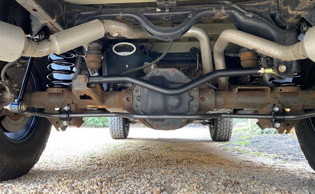

I think I'll try flipping the bar so that the bend is facing upwards and backwards. It looks like it would have clearance this way, but we'll see. I don't feel like going through the hassle of returning it and not too worried about the looks. It's a really nice piece, the joint is beefy and this version has Giiro bushings at each end.

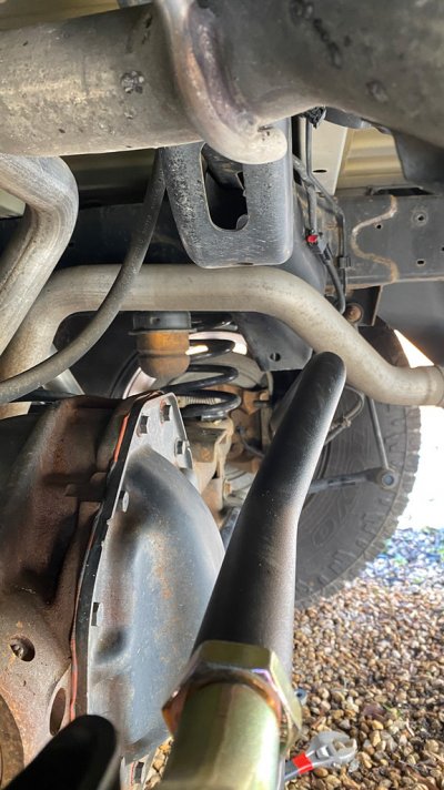

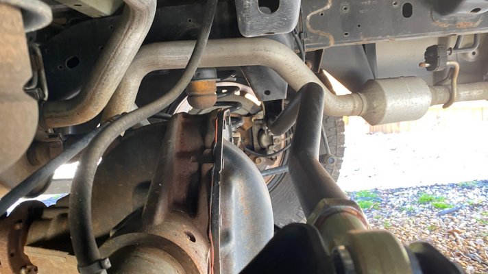

Here it is mounted with the bend facing backwards and up. It does kind of look like contact would be possible on the upper round part of the frame.

Ty for all the testing, this is what make this community the best RAM forum out there. What's your measurement from the bumpstop pad to the jounce ? it seems the bar may clear with the bent up but barely.
Now on another thought after looking at all the pics and angles, i think you may've found a way to lower the angle of the bar without a relocation bracket :) so bent down looks a lot better and should function better too.
Per your pics, i like it with the bent pointing down with the JJ on the frame from a functionality perspective

Just Called Clayton, They have 1 straight left :) the other is on its way to me ;)
They are looking into making a Ram 1500 line and maybee making the straight one again if enough demand for it.

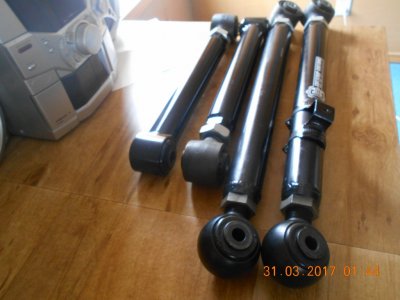

Installed it today, fit like a glove. Ripped out my Hellwig sway bar and End links and bead blasted them will paint them up this week. They were rusted solid but Hellwig were nice enough to warrenty the end link bushings.
To bad i didn't know you back when Cutter-up was still making suspension components,as Rob was building some of the heavy dutiest stuff i've ever seen,but in those days he was specializing in suspension components for the high horse Diesal guys,now he just builds their engines though,lol.His trackbars and lower locating arms were double adjustable,and he was Calgary based.DSCN3969.JPG

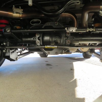

Oof, that's awesome. Do I buy one and swap it out for the bent version? I wish they had these before I bought mine.
Any thoughts if I'll have an issue with the sway and pan hard making contact?
This is with Icon 1.5 springs, core 4x4 +2 end links and Hellwig sway:
