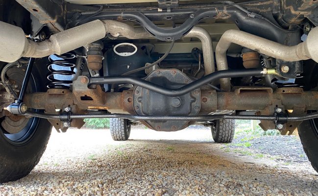

You could always test it. Chalk the front tires. Jack up one side of the rear axle as close to the tire as possible to test your flex and clearance. Then lower it and do the same on the opposite side.

Oof, that's awesome. Do I buy one and swap it out for the bent version? I wish they had these before I bought mine.

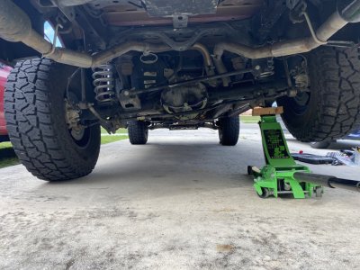

Any thoughts if I'll have an issue with the sway and pan hard making contact?
This is with Icon 1.5 springs, core 4x4 +2 end links and Hellwig sway:
You should be fine. Like Crazy said you can always test.
