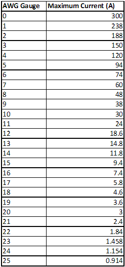

What gauge wire is coming from the drl? This is usually a good indication of what size fuse you should be considering. Here's a wire guage chart showing the amps the wire size is generally rated for.
