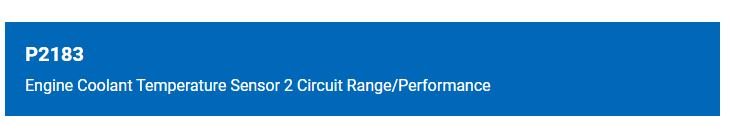

Hi all,
Got a check engine light today. The code is p2183. Anyone got a pic of where that sensor is so I can have a quick look at it?
