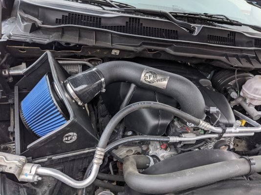

Even if it doesn't make J S for extra HP I still like the hardware I put in when I first got my Hemi 1000002783.jpg
