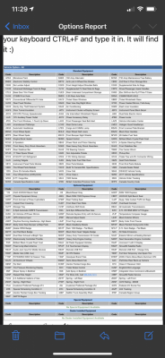

Attached is my options sheet.

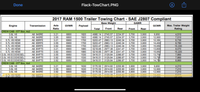

I see that your 2017 Ram 4x4 has the Express trim
The chart that i am looking at reads
Towing Capacity 4,810 lbs.
Payload Capacity 1,580 lbs
Those capacities are with the Ram having a full tank of fuel & just the driver in the Ram
If the driver has a cup of coffee, the weight of the coffee has to be subtracted from the 1,580
This particular chart does not happen to say the weight of the driver, but i think that it would be 150 pounds
From what I was told I think it’s just over 8000lbs capacity. On the options it does have express trim but there are some other options that increase the capacity.

Can you take a picture of the drivers door post sticker
I believe that has the capacities on it
See the highlighted selection at the bottom of the sheet attached. That’s my truck. This is from the dealership. I haven’t had a chance to get a picture of the door yet.

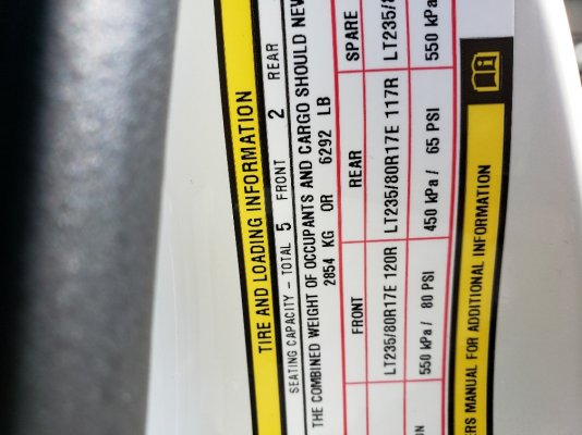

OC455
Apr 20, 2018
3,326
3,017
Central NY
2018, 2019
Go to here: Ram Towing Capacity | Towing & Payload Capacity Guide (ramtrucks.com)
Enter your VIN and it will show you exactly what your trucks cargo capacity and towing capacity is.
Then look at you driver's side door jamb sticker (yellow top boarder) and match it up and see if it is the same.
The charts will give you a basic idea of what it might be. Not the actual capacities. Most salespersons at the dealers don't know this. So they reference the chart.
OC455
Apr 20, 2018
3,326
3,017
Central NY
2018, 2019
The sticker looks like this:b1c23bbab9b369eb08eab4c70f51d832.jpg
OC455
Apr 20, 2018
3,326
3,017
Central NY
2018, 2019

Your max towing should be around the 8500lbs range. I had a 2013 1500 3.55s Express and my max tow was 8650-ish. Payload was about 1350lbs. I'd stay at about 70% of max and you should be fine. Payload will probably be closer to 90%.
