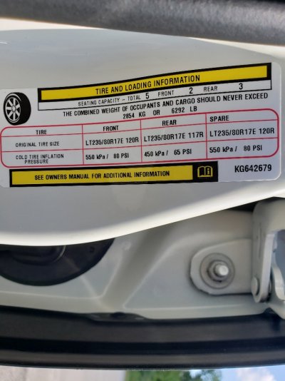

You could never have a payload of 6,292 pounds
That has to also have the weight of the Ram added in,
Your Rams empty weight is
Curb Weight
5640.00,
This is your Ram, check it out
Sorry about the text size below
2018 Ram 1500 Express 4x4 Crew Cab 6'4" Box Features And Specs
https://www.caranddriver.com/ram/1500/specs/2018/ram_1500_ram-1500_2018
That's my payload sticker for my 3500 dually. Not his 1500. I was just showing the OP what the door jamb sticker would look like. 14000lbs, minus 6292lbs., is 7708lbs, is my curb weight.
