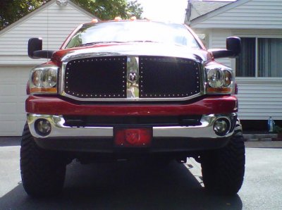

TRUCK IS DONE.
Feels totally different. Feel more power with less pressure on the pedal, and feels like it shifts smoother too.
Also put my new tactical grille in this morning.
