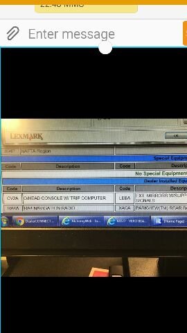

Figure I will share this update here as well ...
Long story short. My SLT truck came with ra2 and compass but it never has worked consistently, more like 30-40% if at all.
Va Dealer couldn't fix it with a new module (3 tried by them/me), wiring is good, seems to be a configuration issue IMO.
I just recently realized that I can cycle the key a second time and get a reading to show everytime , even without the compass module plugged in.
(appears to be using the GPS signal for an active heading, not the compass).
Likely need a trip to a dealer willing to play around with the sale codes/bcm configuration to fix it. Hard to do on 3rd shift without a spare vehicle to drive.
