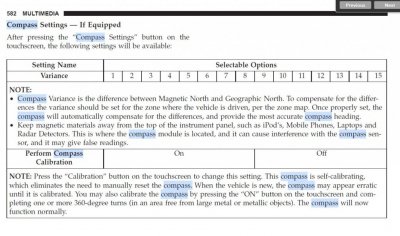

From manual:
other web:
Compass calibration
This compass is self calibrating which eliminates the need to manually set the compass. When the vehicle is new, the compass may appear erratic and the CAL symbol will be displayed. Complete three 360 degree turns in an area free from large metal or metallic objects in not less than 48 seconds. The CAL symbol will turn off and the compass will function normally.
Manual compass calibration
If the compass appears erratic and the CAL symbol does not appear, you must manually put the compass into the Calibration Mode. To put into a calibration mode: turn on the ignition and set the display to comp/temp. While pressing the US/metric button, press the comp/temp button for at least 10 seconds until the cal symbol appears. Release both buttons and complete three 360 degree turns in an area free from large metal objects in not less than 48 seconds. The cal symbol will turn off and the compass will function normally.
Later note:
