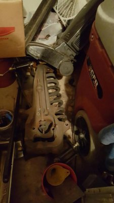

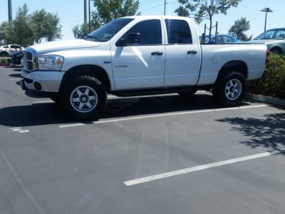

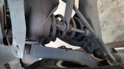

Okay this is the lift on my 08 ram 1500 2wd... Thats just the front in the picture.
I have 35x12.5r18 tires and rims on it. I want to go up to 22's with 35's is that possible with the lift i have?
[/ATTACH]

Looks like a 3" leveling kit to me.

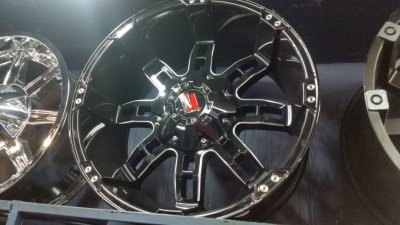

You're running 35's already so as long as the 22's aren't ridiculously wide with a negative offset they'll fit no problem. Wheel diameter doesn't mean anything in the grand scheme of things. Only the wheel width/offset and tire diamater/width matter. You haven't really given us enough information to give you a solid answer. We need more info on the wheels.
