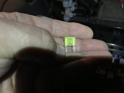

2012 BlacK LL
Mar 11, 2018
9
Downers Grove
5.7L
You are the “man”. It’s a 20 amp fuse on the left side of the fuse box. I am pointing at it. Sure enough It was blown.
Thanks again. Really thanks!
