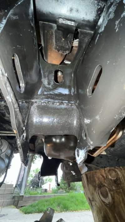

Go both sides from a donor truck. I’ll take some measurements then weld them up with the miller mig. I’ll sand blast and paint them prior to installing. I’ll keep everyone posted once the truck is back together. Probably tear down the truck tomorrow and then reassemble next few days. Ready to shed this weight and be back to stock height/percormance. One huge bonus is since I have 3.92s my power will restore with factory 31.5” tires. I went with a V rated tire and KYB struts and shocks. The new Moe’s performance cam will thank me for the weight shed I think.

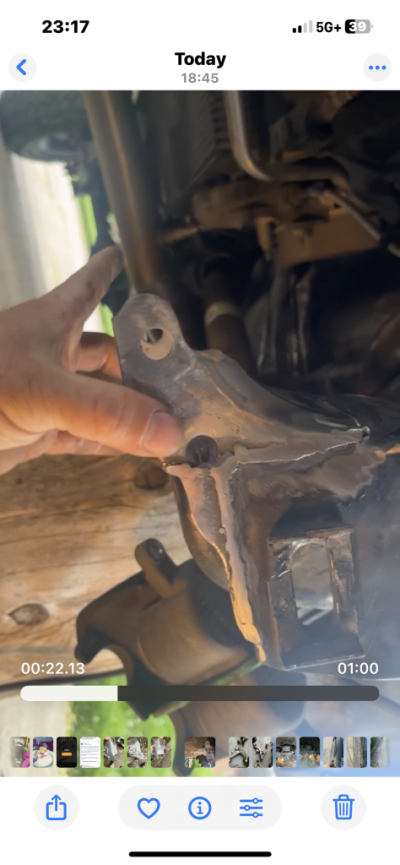

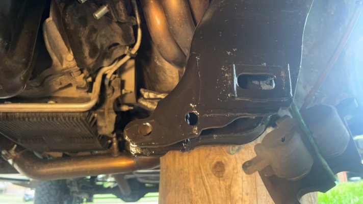

Well everyone, I got the donor pieces sandblasted, laid out my measurements on them, cut them out, and then used the miller mig to burn them in. I’m not pro welder but it didn’t turn out to bad. These are pics after painting them. Now I wait for the IHC 3/5 drop kit to arrive. I got the kyb struts in the mail, front end is tore down and just waiting for drop kit to get here. I

As we were talking earlier Mack,i think you did a hell'va job gluing it back together,nothing wrong with your welding skills.
