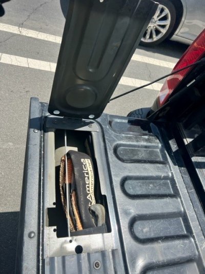

Invest in tools- figure it out on your own- the only limitations are the rods and the latch- and keeping enough strength in it. All my straps, shackles, and recovery stuff are in mine. I only messed with the removable cover but you could cut more as you wish. Make it yours, i just used some cheap hinges and some turn latches, but they only get opened every once in a poor decision when i need them.
Looks like you have something built into you bed as it is. Would be interested in seeing a wider shot etc, and what’s its purpose?
Yes, yes. Inquiring minds want to know.
I see the tailgate is cut. Need more details.
