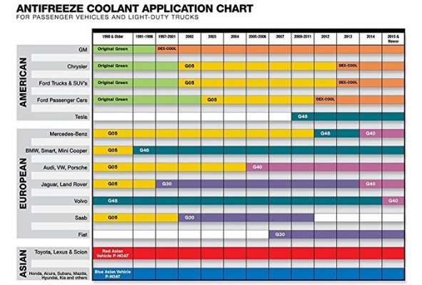

It is a G05 clone, but stick with Mopar. G05 is a different color, so once you move over it is hard to determine how clean it is. Stay with Mopar HOAT orange and it helps determine the shape of the cooling system. It is a 5 year coolant, but I like moving to a 3 year interval because it is near impossible to get drivers side bolt off, so you never get 100% out. Buy pre mix, or buy concentrate and mix it 50/50 with distilled water, and let nothing else go into the system.
