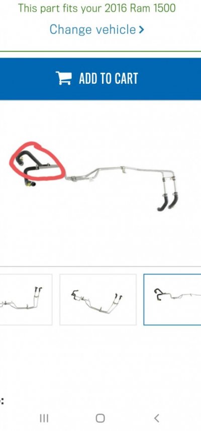

Does anyone know if there is a part number associated with just the circled hose? Only thing I have been able to find is the entire supply/return heater core hose. If not, thinking about just getting some bulk heater core hose, and making my own, with a loop in it.

Hemi water pump inlet tube, just posted it the other day.
Mopar 53022199AC​

if that aint it no matter they sell every section, just need to know where it is attached to name it.
