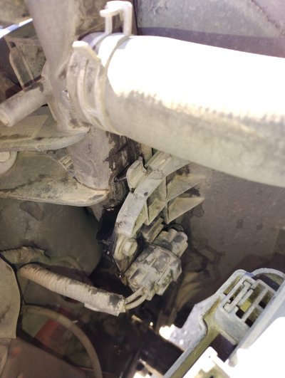

Two days ago I noticed the smell of antifreeze. I just figured it was coming from a car parked next to me.
Today I drive my truck and smelled it again while driving. After parking, I noticed a little coolant puddle underneath the front driver side on the ground.
My temps aren't rising past normal at all. About 199-203 cycling normal.
I popped the his and saw this...
The upper radiator hose connection feels dry.
Any ideas?

Yours is about the 5th or 6th one (including mine) I know of that leaked like that.
Might be radiator time.
If you have a pressure tester, top off the coolant and pump it up to 15 psi.
Here was mine:
If it is the radiator leaking, don't chance it.
Mine decided to fail the night before an 800 mile trip, was filling up and had to get towed 12 miles home.
Imaging the bill if we were out in the middle of BFE.
Good luck.

18 Ram Tradesman 1500 3.6, 8 spd, 200890 miles. Mine just developed that same leak. Adjacent to the drivers side radiator mount. I was blaming it on a couple recent pot holes that jarred the truck bad. Now have the radiator out waiting for the replacement to arrive. Two bolts on the passenger side were very difficult (without electric tools) but I did it without having to open up the ac system or open the trans cooler lines. To my surprise the trans cooler is part of the ac condenser.
It is a challenge to fiqure out the interlocks for the AC condenser and the radiator to get them apart.
Recommend having some extra splash shield pins available. Some will break even with a trim tool.

Mine was leaking at the lower driver's side corner and the drain valve is right there and tightening it stopped the leak for a couple weeks but then it started dripping again. I'm afraid to put much more strength on the valve for fear of breaking it so I'm going to take it to the dealer (warranty). I initially didn't realize I can reach the valve from the top and took out the wheel well liner but if you want to give it a try you can probably get to it. I definitely don't see a way to get to it from underneath.

In the tradition of building everything to fail, it is your rad design. Aluminum with plastic tanks.
They fail and leak were the plastic tanks meet the aluminium.
They can't be fixed either like the old copper rads they require full replacement.
There are a lot of inferior aftermarket ones too that are cheaper but won't last.
Sad as it is your best bet is probably an OEM one that will only last slightly longer.

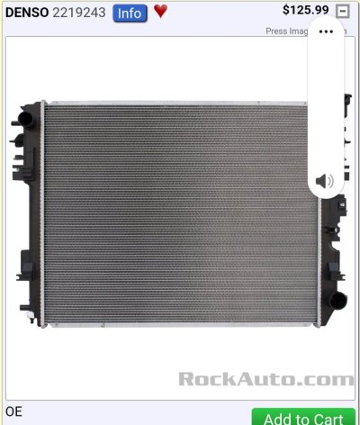

Anyone have recommendations for an all aluminum preferably or after market brands.

This is the one I got for my '15. It was $100 additional to ship, so allow for that. It was still a fair bit cheaper than in my local area.
Check fitment for yours. If a Classic, should be no issues.
Was a perfect fit.
Recommend you remove the grill, loosen the AGS, and remove the reservoir. Makes unbolting the condenser alot easier.
Others have used an all aluminum one, but had to mod a bit to fit. Not sure what brand/model.
