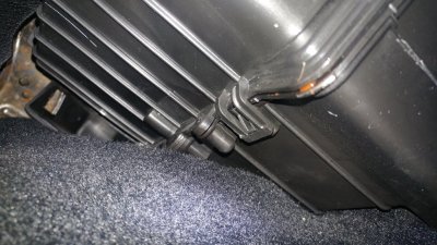

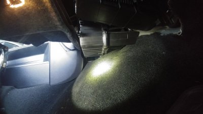

Ive recently noticed a really breif smell of coolant when i turn the vents off then back on but it is not constant. I pulled glove box and pulled back carpet and notoced a small drip in the hvac seams.
Im pretty positive its heater core but any other guesses?
Small orange drip

Yes, that could certainly be a heater core leak.
